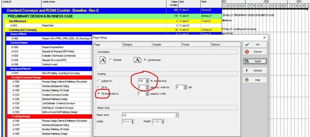

As I have mention to you before, you can play with the scale by increasing the zoom scale until you get the desire column size or the timescale meet your requirement. ex: J,F,M...
see below:
Timescale1

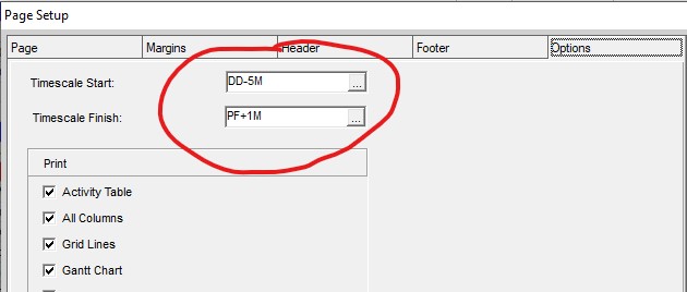

In addition to that, if the print out is too big, you also need to adjust the Start and Finish of the Timescale by increasing the range as per example below:

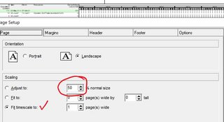

Printing is different. You can adjust the zoom on the print settings see below:
Timescale
You need to do a trial adjustment until you are satified on the timescale column size.
