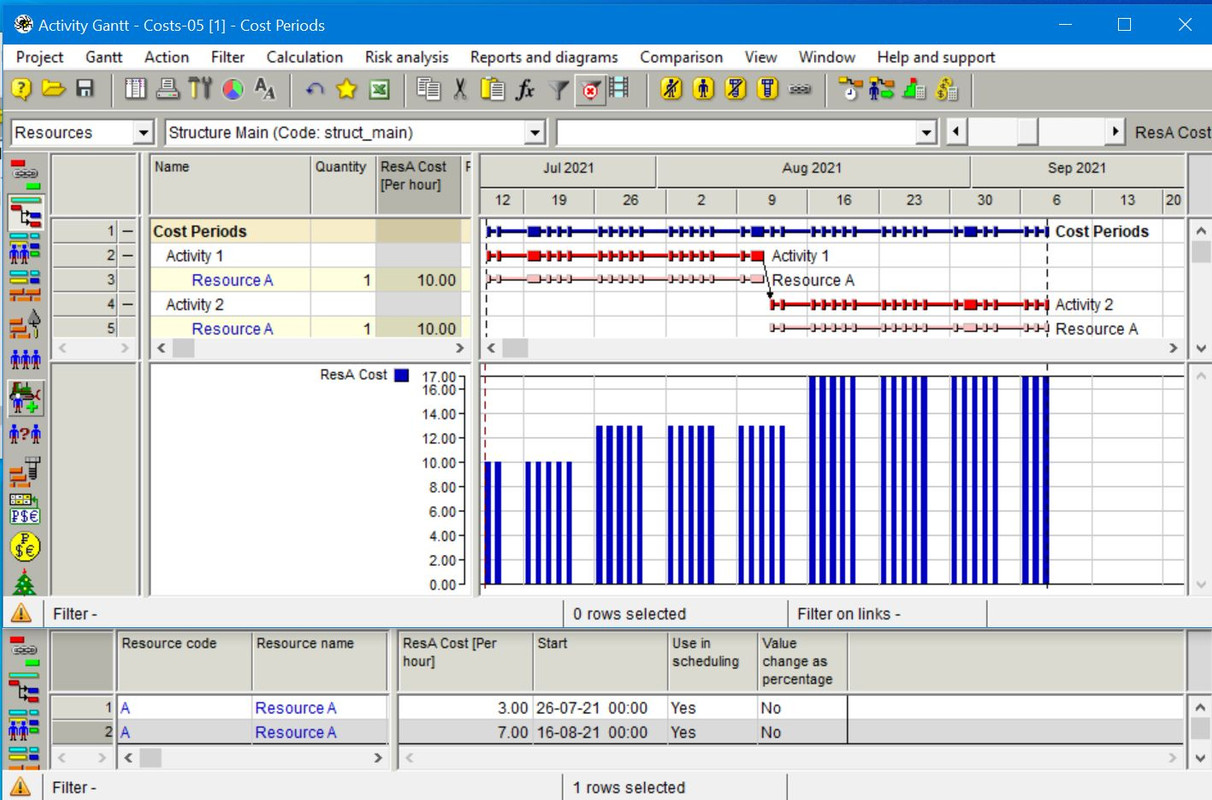

Be reminded that cost increases usually happen in steps many times during project duration and might require periodic updating. In the following example within project duration Resource A cost had 2 price increases. The procedure must be easy to apply and edit to expectd multiple price increases within project duration for all cost items.

Try using performance periods.  I am not sure how it will work in P6 as I do not use it but I am aware of it.  I use Spider Project and we do not have the need to use performance periods them as Spider can figure the correct distribution automatically using basig math.
More interesting is the case where you need to include projected price increase, inflation is a very common scenario.  In Spider Project we use Cost periods to reflect projected changes of project costs. The user can create cost periods if it is needed to change planned cost of cost components, materials and resources in certain project periods.  I have no idea how this is done in P6 but there must be a way.
