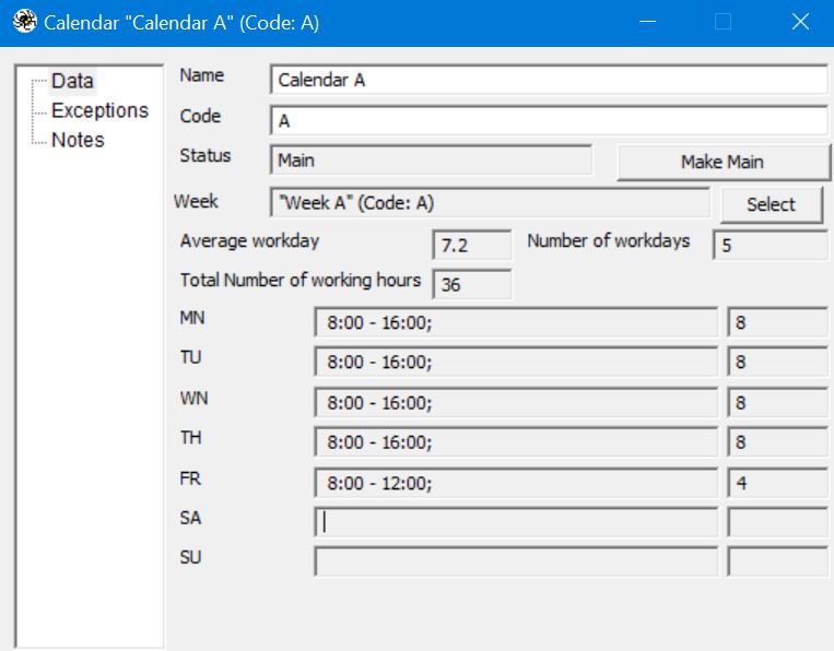

There are 3 resources of Skill A, quantities assigned, resource productivities and activities volume of work, as per image. Activities and resources work on same Calendar A. Note same resources can have different productivities for different activities, in this simple case Activity 2 productivities are reduced by 20% because of work conditions. After leveling duration hours, quantity distribution, volume of work by resource and resource hours will be adjusted as necessary. If any activity is delayed for whatever reason the resource leveling algorithm will take care of selecting the distribution that will look for shortest schedule duration at a click of the mouse.
Easy, only 3 activities and a single resource skill all working on the same calendar.
