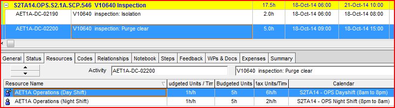

My problem is when I assign the two resource to an activty (assigned both of them cause we won't know what exact time the activity may fall under when we change logics), both resource registers the same manhours (please see image below).
On the example below, the manhours should only register to day shift resource (9am to 3pm). Note that resource calendar has been modified specific for day shift (8am to 8pm) and night shift (8pm to 8am the next day).
1981

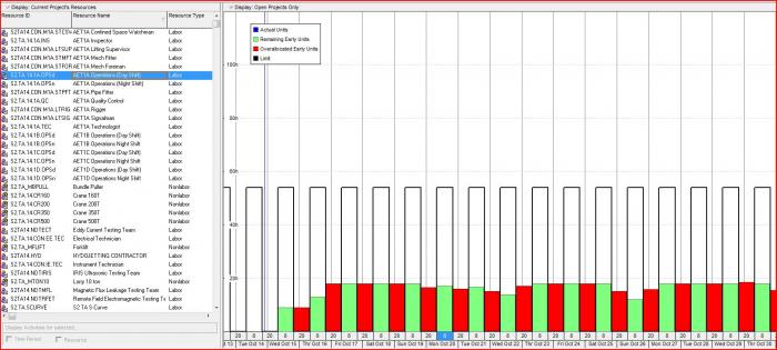

Day shift before leveling
1982

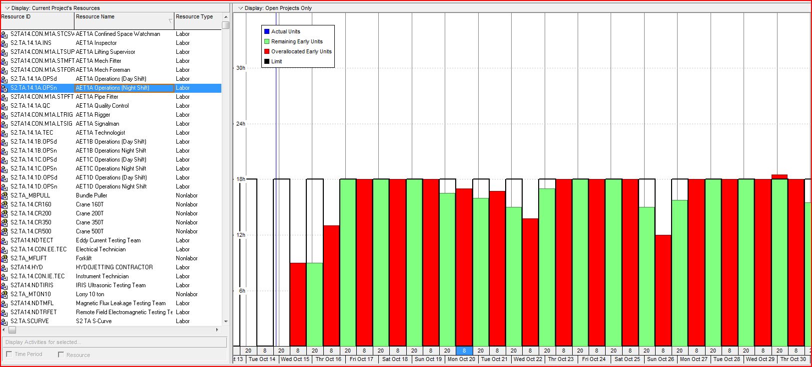

Night shift before leveling
1983
DAY SHIFT AFTER LEVELING
1984
NIGHT SHIFT AFTER LEVELING
1985
If you've noticed, when I leveled both the resources, it followed the night shift constraint (which is correct because it is the lesser between the two) but what I'm trying to achieve is for the system to follow the constraint in the day shift (6pax) and night shift (2pax) which, in this case, was not followed. Note that the current practice in our side is to average the resource which is okay but doesn't really show the true picture on site.
