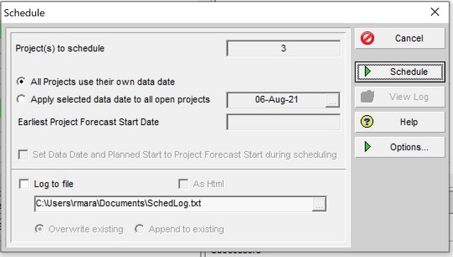

Like what I have mentioned, depending on the project requirement and setup. A good example is the mega project that we are managing where the design are done in Thailand, Fabrication and manufacturing are done in different countries such as Germany, China, France and Philippines, the actual project is in West Africa, the PCM in Australia and stakeholders are in Abu Dhabi. I have a different projects setup in one portfolio where data date are difference from each other. Some activity dependencies are from different projects. Due to pandemic, resources are limited to each country. Each project are being update on different location and manage in Australia. In P6 release 20, there's an option that can shedule the portfolio project's with a different data date.
Data-Date-Schedule-Option
Andrew,
you wrote: In the portfolio, each project can have its own Data Date.
Activities of portfolio projects can be linked with each other, portfolio resources can be limited and there can be othe reasons why projects that belong to the portfolio cannot be scheduled separately ignoring their interdepencies.
So there is a need to schedule the whole portfolio for getting the schedules of all projects that belong to the portfolio.
It can be done only if all of them have the same data date.
