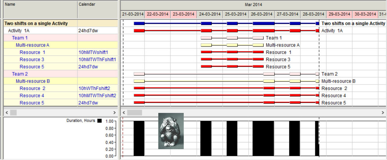

yes you could do as Rafel suggested and modify the bars to show non working times and you will get the short staccato effect on the bars
User offline. Last seen 12 weeks 6 hours ago. Offline
In any case I would require the Gantt to show more detailed bars where you can distinguish work hours versus non-work hours.
Detailed-Bars
