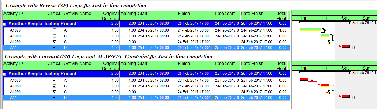

The dates you indicate are inevitable given the nature of the logical constraints.  With B>SF>A, you are dictating to the software that A's finish MAY NOT PRECEDE B's start.  Such time/date precedence relationships are at the core of the forward and backward passes, before calendars ever come into play.  Since B starts at 0700 on 24Feb, the forward pass first set's A's finish at the earliest possible time (not before B's finish and within A's calendar) of 0700 on 24Feb, then it subtracts the 1day duration (according to A's calendar) to arrive at A's start at 0700 on 23Feb.  There is no work during non-working time - A's work is done on the 23rd, but the night is spent idly waiting for the SF constraint to be met before the finish can be recorded.  You may be tempted to modify the relationship to B>SF-0.01h>A, which gets A's finish back to the end of the previous day, but of course it's start is pushed back to the end of the day before as well (unless you shorten its duration by 0.01h).  All of this is is pointless.
You have never explicitly stated exactly what the hard logical relationships are among A, B, and C, but I get the impression that A and B are preparatory works that must be done just in time for (finish) Milestone C.  I guess you are using C>FF>B and B>SF>A to pull them along as C moves due to external constraints.  Aside from your stated concern over the finish dates, such an approach also corrupts the flow of driving logic through the schedule network - float values and associated critical/near-critical definitions won't be reliable.  If this is the case, you would be better served in my view to use the correct logic A>FS>B>FF>C, then apply just-in-time constraints (what we used to call Zero-Free-Float and what P6 calls "ALAP") to A and B.

This is what I got if using Spider Project software, but it looks like P6 calendars are a bit tricky. Spider Project do not have such issues and seems like also Asta do not have such issues.

Thanks for the input. Maybe i used the wrong terminology (backward pass schedule) which took the discussion in a different direction. Since I cannot attach images, I will try to explain the scenario in the most simplistic manner that i can. It is infact pretty simple and I am sure someone somewhere has come across the same issue in Primavera and knows a way around it. I have used similar logic in other software in the past (eg Asta power) for Interface schedules with success. Howeever, currently P6 is my only option.
Here is an example of my activity flow;
Activity A (1d)  <----  Activity B (1d) <------  Milestone C*  ------> Activity D (1d)
Milestone C is my main driving milestone for all activities surrounding it. For eg, if Milestone C must finish by 5pm on 24th Feb, the rest of the activities should ideally be;
Activity A 23Feb 7am-5pm <---- Activity B 24Feb 7am-5pm <---- Millestone C 24Feb 5pm* ----> Activity D 25Feb 7am-5pm
Milestone C is a variable (as always the case in Interface schedules) and moves frequently. I want all the remaining activities to constantly move accordingly as per Milestone C date.
When i implement this in P6, Activity A is being pulled past non-working time into the next day even though all activities have the same calendar.
Activity A 23Feb 7am-24Feb7am <--- Activity B 24Feb 7am-5pm<---Milestone C 24Feb 5pm*---> Activity D 25Feb 7am-5pm
Anyone knows why this would happen?
