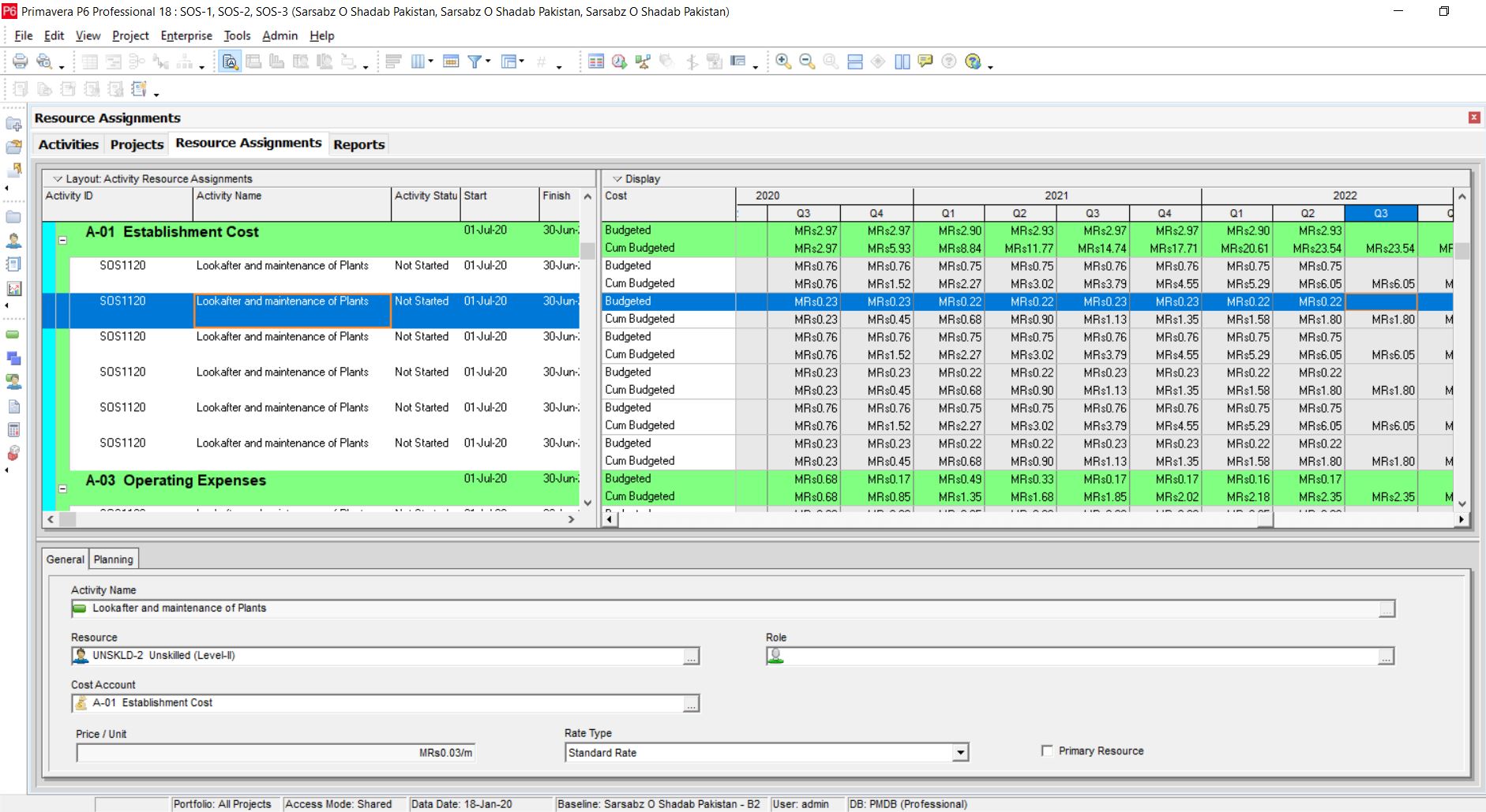

I have developed a Cost Account Dictionary (Budgetary Heads), that I have to use for Accounting Software of my Enterprize. I am working at a Program Level and want to Develop a Report of Annnualy Funds Requirement by All Projects  by using Resource Assignment Layout. What I get is shown in Pic below:
7241
But I want to collapse the data for projects only not at lower level (activity Level). Can any one help what should i do.

view show on bottom resource usage profile

Please tell me what should I do??? I just want to get cash flow of multiple projects grouped by Cost Accounts
User offline. Last seen 14 weeks 1 day ago. Offline
my instructions never said to use resource assignment layout.
please follow my instructions to get what you want

resource useage profile and activity useage spreadsheet commands are inactive in resource assignment layout
view show on bottom resource useage profile
or
view show on bottom activivity useage spreadsheet and then roll it up
