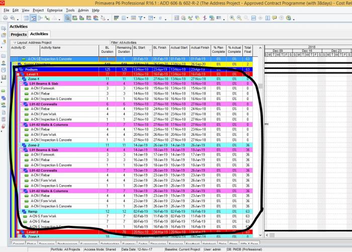

In our project plan, I want to filter acitivities under Podium - Level 01 (Activties circled in attached image). Please help.

Dear Bros.... Thanks all...
I used filtering by activity codes and it worked.
Thanks again for your support.

codes will work also and are much more flexible than using a wbs

I am assuming that these activites have been assigned a wbs and not codes.
Therefore filter where wbs is under Poduim Level 1
