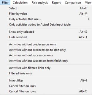

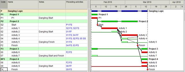

Some scheduling software misses to properly identify open end activities. An activity might have a FF predecessor and still be start dangling.  An activity might have a SS successor and still be finish dangling.
Dangling-Activities
The filter as well as the scheduling report shall distinguish activities without predecessor / successor only and activities without predecessor to start only / successor from finish only.
Dangling-Filter
The following is a case where an activity [Activity 11] with predecessor and successor is dangling at start and finish nodes.
Activity-with-succ-and-predecessor-but-dangling-start-and-finish
