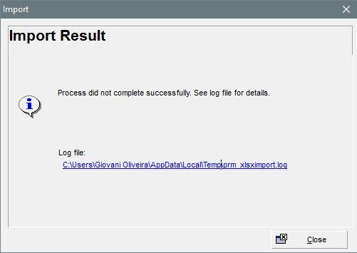

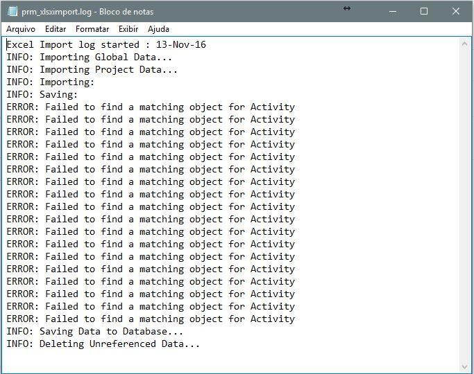

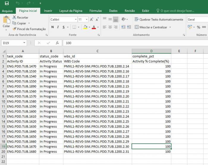

Hi Everyone!
I'm seriously in trouble after upgrading to R16.2.
My excel imports do not work.
I am using MySql database, Spring P6 R16.2 x64. (I already installed the 32bit version, same problem).
Has anyone ever been through this? I ask for help.
Thank you
