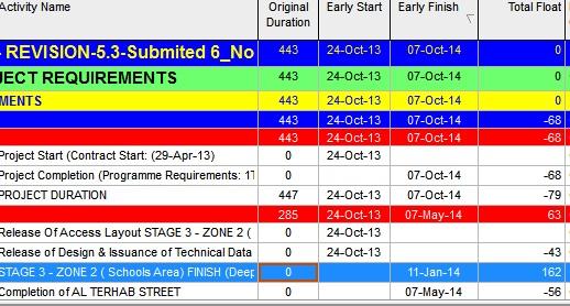

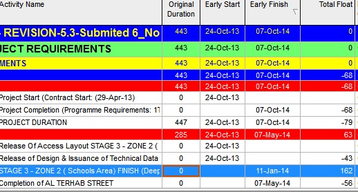

Dear Primavera Experts,
 My question is, How can I display the total float on the Project summary level?
The project completion milestone delayed 68 days (TF=-68), But on the project level it shown (TF=0), how can I display on this level the same TF whatever it's negative?
Please view the picture below.
NB.I use P6 R8.3
Thank you for your help in advance.

I get it, I must add Must finish date to project to get this TF.
