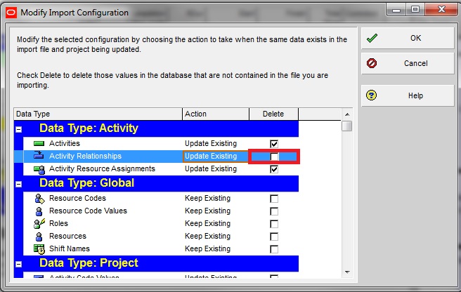

the external links to the other schedules do not exist in each of the contractor's schedules, so what I tried doing was to import the XER into an existing schedule (my consolidated schedule) as an UPDATE, but to retain the external links I had to uncheck the "Delete" option under 'Activity Relationships'.
What this causes, is that every time the contractor deletes the links in their schedule, it gets ignored in the update, hence my version is not 100% aligned. We have requested the contractors to keep schedule changes log, but keeping up with all changes is too labor intensive when the contractor changes the sequence of their works etc.

If I understood you correctly, what you want is to import contractor's programme without importing the external link from other projects. If this the case, then you must change the "Keep Existing" to "Do not Import" under the "Relationships to External Projects".
