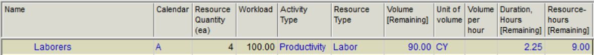

As far as I recall P6 does not have productivity(volume of work per hour) field, multi-resources, nor resource quantity(ea) so you will have to figure out activity duration and for each resource calculate resource units or effort hours.
2021-09-05-19-43-41
2021-09-04-20-07-10
The basic formulas would be:
activity duration(hrs) = volume of work / volume per hour
  • = 90/40 = 2.25 hours
units for each reasource = Resource Quantity(ea) x Workload x Duration(hrs)
  • for Laborers = 4 Laborers x 1.00(100% as a real number) x 2.25 hours = 9.00 resource-hours [Remaining]

But are there  Productivity in Activity Type in P6?
User offline. Last seen 3 weeks 4 days ago. Offline
Most work is done by many members of different skills working as a team/crew.  You need to distribute the total man-hours among each of the resource skill.  Easy if you know the volume of work, the production rate of your crew and the crew composition.  At home, estimators and experienced Project Managers are good at this, they use the company records for their estimates and for tasks they have no record they use references such as RS Means.
RS Means Basic Calculations
www click on thumbnail.
If production type, enter the volume of work, select the crew and the production rate and the software will determine the activity duration, if duration type duration is fixed. When using multi-resources the whole crew is assigned; resource quantity for each resource and their workload if part-time and everything else is done by the software, transparent and so easy.  I expect P6 to be a bit different but as easy.
