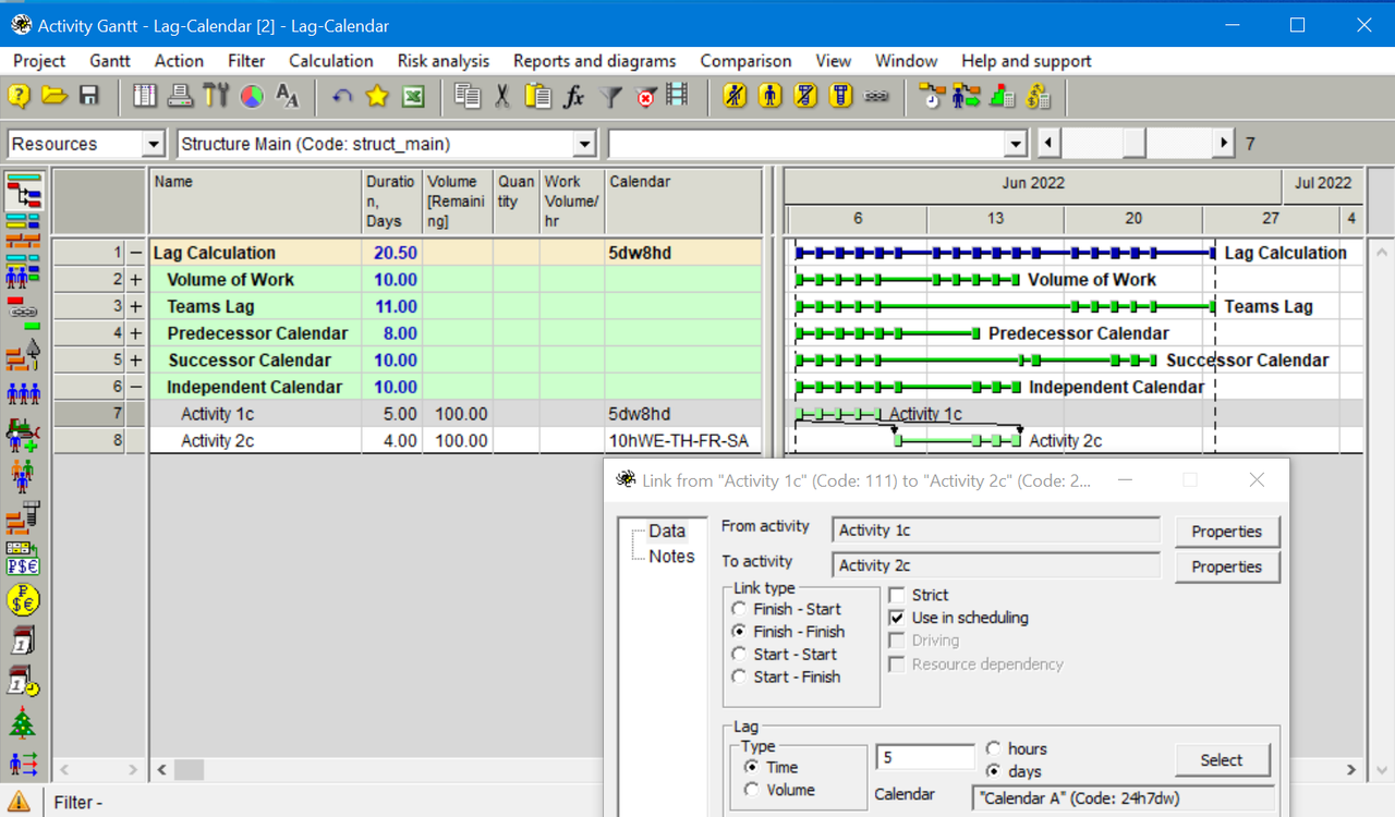

Below is example from Safran Project, you can set the calendar relationship calendar per link, use different duration units fro the link and even set the lag value to be as a %.
User offline. Last seen 11 weeks 5 days ago. Offline
Individual calendar links are a basic feature in Spider Project, more advanced features are volume of work lag and double dependencies with lags.
2022-11-17-04-56-52
