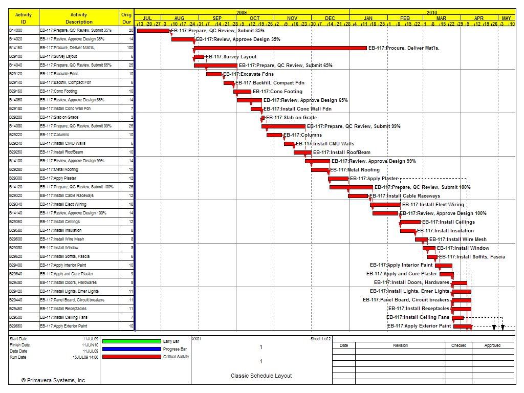

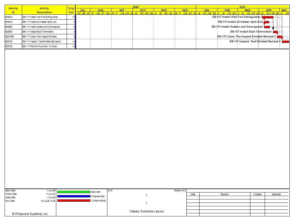

here is what the logic sequence looks like for my example of activities i posted below:

As a Jr. Scheduler/Planner and one without civil eng. degree or Architectural one at that. I had to teach myself a lot of new terms/Ideas/Concepts about planning and scheduling and just about building in general.
In the first three years of working as a scheduler, I dont think I learn as much as I have in the last year and half. Yes, i can use the tools (Primavera) I think fairly well but that should be expected. What i mean is that you can not call yourself a painter if you dont know how use a paint brush or a carpenter without knowing how to use a saw or hammer. The tools are the simple parts of the job but the concept that takes time to learn.
What I have done last year and this year is that i have spent a lot of time reading and researching everything: i can get my hands on. I have a Huge library of pdf files. This Files are about scheduling best practices, Key Performance Indicators (that is a huge topic and in itself), Earned Value Management, Risk Management, QC Management, etc. Lots of this stuff is from people on this forum such the great Aussie Paul Harris.
I dont know when your interview will be but if they know that you are just begging i dont think they would be asking you a great deal of difficult questions.
IMHO, is would probably be best for you just to read the basic scheduling info. such (what a Start-Milestone, Finish Milestone, Hammock (Summary Activities), Level of Effort, Constraints how they used or applied to the schedule. How to create a WBS and also the OBS and assigning the resource to a work package. How you would resource and cost load the schedule. Relationship types are important too (SF, SS, FF, FS) and what Lead & Lag are? I also think they would ask you about baselines too? They def. ask me these silly questions on the first interview and more detail stuff on the second. I am a Jr. Scheduler too.
I think i read on your profile that you are a civil eng. know? If you are there is a great probability that they will ask you how you would build small project of 30 to 40 activities such as this example of an Army Enlisted Personnel Barrack (EB-117:)(this is just an example and they can be many dif. variations of this sequence of work but this is just mine method. It could be right or wrong but it was approved by the Army Corp Of Engineers)
Activity description
EB-117:Prepare, QC Review, Submit 35%
EB-117:Review, Approve Design 35%
EB-117:Procure, Deliver Matls,
EB-117:Prepare, QC Review, Submit 65%
EB-117:Review, Approve Design 65%
EB-117:Prepare, QC Review, Submit 99%
EB-117:Survey Layout
EB-117:Excavate Fdns
EB-117:Backfill, Compact Fdn
EB-117:Review, Approve Design 99%
EB-117:Conc Footing
EB-117:Prepare, QC Review, Submit 100%
EB-117:Install Conc Wall Fdn
EB-117:Slab on Grade
EB-117:Columns
EB-117:Install CMU Walls
EB-117:Review, Approve Design 100%
EB-117:Install RoofBeam
EB-117:Metal Roofing
EB-117:Apply Plaster
EB-117:Install Cable Raceways
EB-117:Install Elect Wiring
EB-117:Install Ceilings
EB-117:Install Insulation
EB-117:Install Wire Mesh
EB-117:Install Window
EB-117:Install Soffits, Fascia
EB-117:Apply Interior Paint
EB-117:Apply and Cure Plaster
EB-117:Install Doors, Hardwares
EB-117:Install Lights, Emer Lights
EB-117:Panel Board, Circuit breakers
EB-117:Install Receptacles
EB-117:Install Ceiling Fans
EB-117:Apply Exterior Paint
EB-117:Install Wall Fire Extinguisher
EB-117:Install AC/Heater Split Unit
EB-117:Install Gutters and Downspouts
EB-117:Install Elect Termination
EB-117:Clean, Pre-Inspect Enlisted Barrack-3
EB-117:Inspect, Test Enlisted Barrack-3
EB-117:Perform Punchlist, Turnover
Finally is you need articles on how to, I would be very glad to share them with you. It took me a while to locate these information online.
