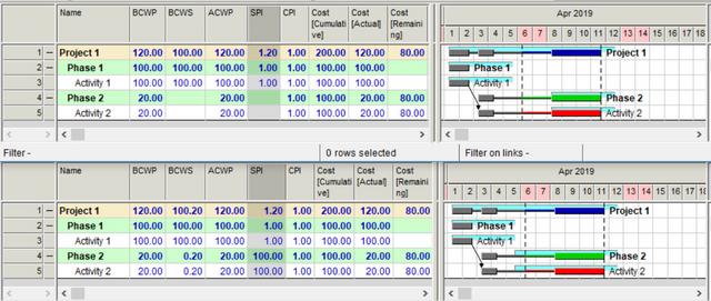

To write any number including 0 when SPI is undefined would be wrong, better keep the SPI field empty and use some formula to identify when SPI is undefined. This will warn others such unusual occurrence happened.
In the following scenario SPI for Activity 2 is undefined while for Activity 3 is 0.
Baseline bars are shown in light blue. Activity 2 is ahead of schedule. If the SPI is less than one, it indicates that the project/phase/activity is potentially behind schedule to-date whereas an SPI greater than one, indicates the project/phase/activity is running ahead of schedule. An SPI of one indicates the project is exactly on schedule. Therefore it cannot be less than 1, in no way can be 0.
When dealing with SPI values "empty" does not always means 0, can mean [in rare ocassions] the value is undefined.

If BCWS=0 then SPI is undefined not 0 as division by 0 is undefined.
Please take a look at the following image.
In the top version Phase 2 SPI = 20/0 = undefined, nothing is shown.
In the bottom version Phase 2 SPI = 20/0.20 = 100.
As the denominator [divisor] goes closer to 0 SPI gets closer to ∞. In ordinary arithmetic, the expression has no meaning, as there is no number which, when multiplied by 0, gives a (assuming a ≠ 0), and so division by zero is undefined.
