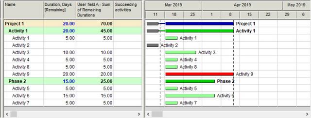

I like Tom Boyle’s approach, no need to use dummy resource loading that can be error prone. I can do it as Tom Boyle suggests with Spider Project if using a UDF and a Script to take control of how field values are rolled-up. After UDF and Script are defined then after any update schedule all I need is to run the script with a single click of the mouse to get it right. Click F10 after defining the script as favorite, a step left out for others to see a script is being used. Because I record my scripts as if a macro recording everything is easy, no need to manually enter script commands. Tom is right when he says best procedure depends on the software.

21 years 8 monthsI like Tom Boyle’s approach,
