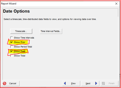

Dear Forum Members.
Could you please explain me where we use below mention function in report wizard window.
What is show prior/post function mean?

  • 7340
  • Show Time intervals
    This option displays the spread for the data item (selected under Time Interval Fields button in above dialog) for each time interval (selected under Timescale button in above dialog) from the timescale start date to the timescale finish date (selected under Timescale button in above dialog).
    In the report above we have selected to display the Remaining Units by week for the month of November.
  • Show Prior
    This option displays the cumulative value before the first time interval.
    In the report above, the Project Manager had accumulated 40 days and 4 hours of Remaining Units before the first week in November.
