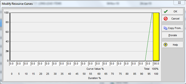

As per the following below Resource Curve and for an activity of  20 Days Original Duration the Planned Value will be exactly located on last day of the activity.
But for any activity with Original Duration more than 20 Days, the Planned Value will not be located in the last day of the activity.
Please advise how we can get the planned Value exactly on the last day of the activity for those activities exceed  20 Days original duration.

by default the distribution of the curve is linear however you can assign a curve by going to the resource tab
right click and select Resource Assignmnets Columns
 expand the General caterory on the left and select Curve and bring it to the right
not it is available in the resource tab
now click in the box and select your curve distribution

Accrual Type - you can accrue at the finish of the activity by using this cell.
  • This you cannot do if using resource curves as the minimum increment is 5%, you need a 0 time event at the end of the activity, not uncommon when dealing with financial resources.
  • For renewable resources it does not makes sense most of the time.  Such allocation makes sense for resource production if using other software but I doubt if using P6 this would ever make sense.  If using P6 only makes sense for financial resources and P6 provides for it.
