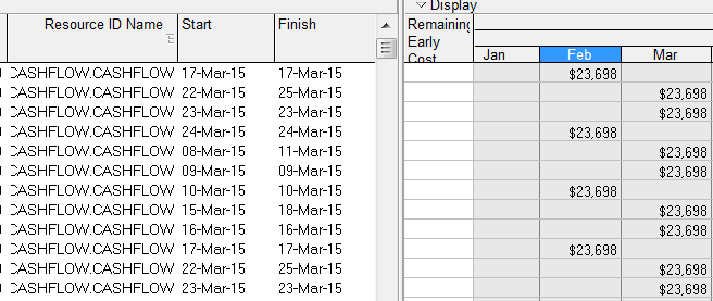

We have a program fully loaded with cost and manpower. The problem that we are facing right now is that lots of costs that were loaded to the program are not spreading to the entire duration of the activity.
Can anyone share his knowledge on resolving this issue?

on the left try changing the column to early start and early finish instead of just start and just finish
check to see if the Drive Activity Dates by default option has been switched off. Make sure that the calendars match down to the exact workhours, because even if a resource assignment is ending on the same day as the activity, if they are out of sync by even 1 hour, then the resource assignment will no longer sync up with the Activity's dates. Make sure you have your Duration Type set to Fixed Duration and Units/Time or Fixed Duration and Units.

Yes. they have the same calendar.
User offline. Last seen 6 hours 46 min ago. Offline
Posts: 2720
make sure that your resource is using the same calendar as your activity.
