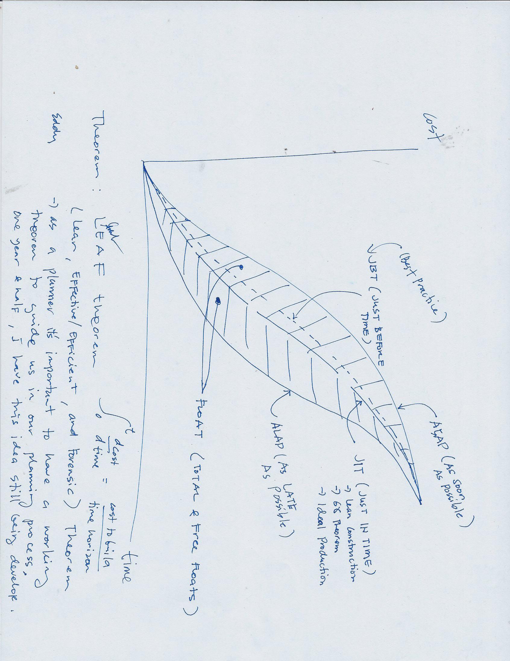

Please SEE this and help me develop, i hope this would be inside the group only..

I would like to particularly develop the Just before Time (JBT), we had been particular on Just In Time (JIT) but there are problems arising fron this model. thank you for your coment Sir..
Eddy,
What you call “Leaf Theory” is what we call S-Curves. You can see a complete write-up on the process in Recommended Practice 55R-06, “S-Curves” for free on the AACE website at http://www.aacei.org/aaceonly/rps/55R-09.pdf. Good luck!
