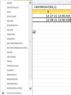

Use date-hour format for granularity.
2022-01-07-05-47-46
Try Date Formulas showing date-hours
2022-01-07-07-22-15

Rodel, It does depend on the nature of the task being assessed. Generally, a one day task in scheduling will be the same date, consider a task starting 1-Jan at 08:00 and of duration one day. The date will still be 1-Jan, but the time will be 17:00.
In Excel, a value of 1 is calculated as a whole 24hr Day. so to check how calcs are being performed in Excel, you will need to display the number format to include hh:mm

Excel is good for dates, just make sure you view the time also as scheduling tools may export the date & time as a fraction of a day, and this can through Excel calcs out.
