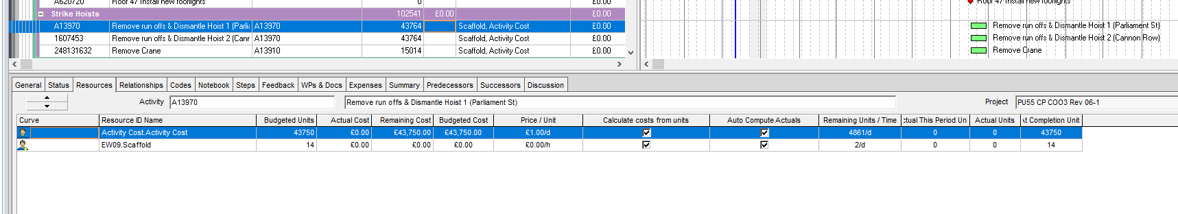

Can i know if i assign the cost correctly in P6?
I am assignning a fixed price lump sum to my activities.
Firstly, i set the labour budgetted unit to $1/day
I then, i set the budgeted unit to 43,750.00 so my cost for that activity is £43,750.00.
With this method, i can use the histograme to see my cost and when i progress the activities, i can see the remaining cost, budgetted cost and actual cost.
I am not sure if i am doing it right method? can anyone please enlighten me please.
The problem with this methid is i have 2 resources in the programme.
Many thanks
Mike

whay do you have 2 resource where 1 can hold both values of manhours and costs
