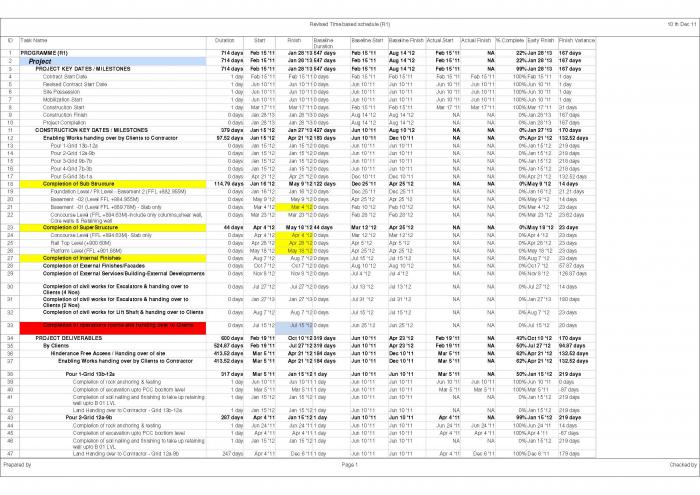

microsoft_project_-_baseline.jpgHi all,
Can a schedule from 15.02.11 to 14.08.12, duration of 547 days tracked as on 15.01.12, have a finish variance of 1389 days?
The above instance is for a schedule of my project. The schedule is tracked based on % complete. I am manually entering the % complete as on the status date. For me to report % complete is the percentage of quantity of that task being completed as on the status date.
Earlier the same schedule tracked a fortnight ago had a finish variance of 153 days as on 31.12.11.
Also on saving as a Baseline and then inputting the values why does the start / finish varies from baseline start / finish dates?
Rohit

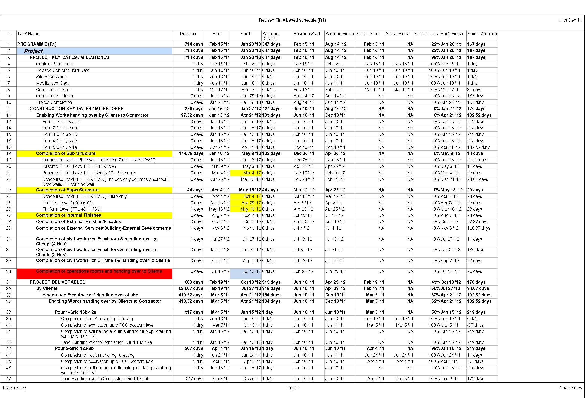

Anning Sofi 👤 Member for 14 years 4 months
To resolve your issue on the 1389 days, try this check:
1) Filter all 100% complete activities
2) Check if your 100% complete activities have actual finish dates.
3) Update the finish dates for the 100% complete activities which has no actual finish dates.
4) rerun F9
5) variance should be correct now
DONE

Hlamalani Baloyi 👤 Member for 14 years 4 months
You cannot just enter %complete, you need to track the actual events, "Actual Start Time, Actual finish Time" then you will get correct information, You baseline is normally different from your ctual information and hence you can forecast you finish date correctly, otherwise if you want your actual information to be the same as the baseline it then becomes useless, it means you are not planning but you are only data capturing.
